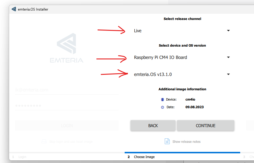

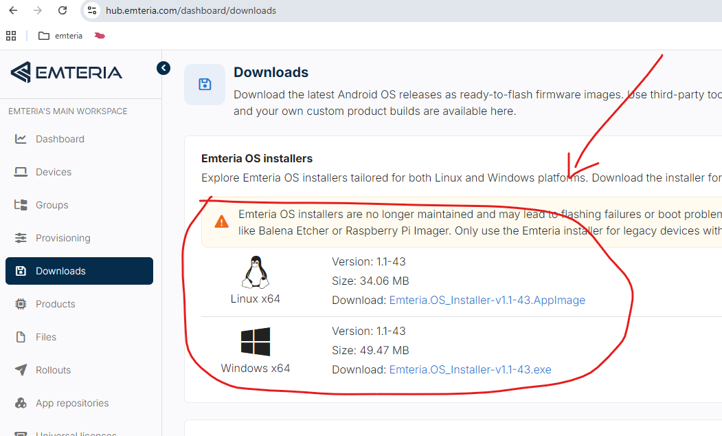

I found our release for CM4IO version 13.1.0 in our legacy installer. This is the same image you used, but in a different package format. You need to install it through our installer application right away.
First, please open our Downloads page and pick an installer for your OS:
Second, login into the installer and pick the correct device and version:
Here are some knowledge base articles to help you:
Please let me know if you can successfully boot the device with Android 13 by using your screen. If yes, we can continue with the next step of making it work on Android 16 or 17.
