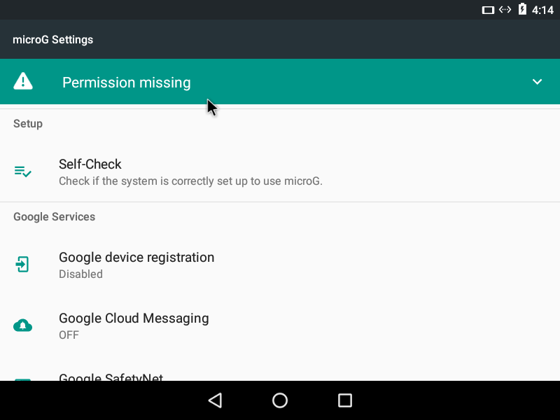

Open microG Settings
Click on Permission missing - allow microG to access device location

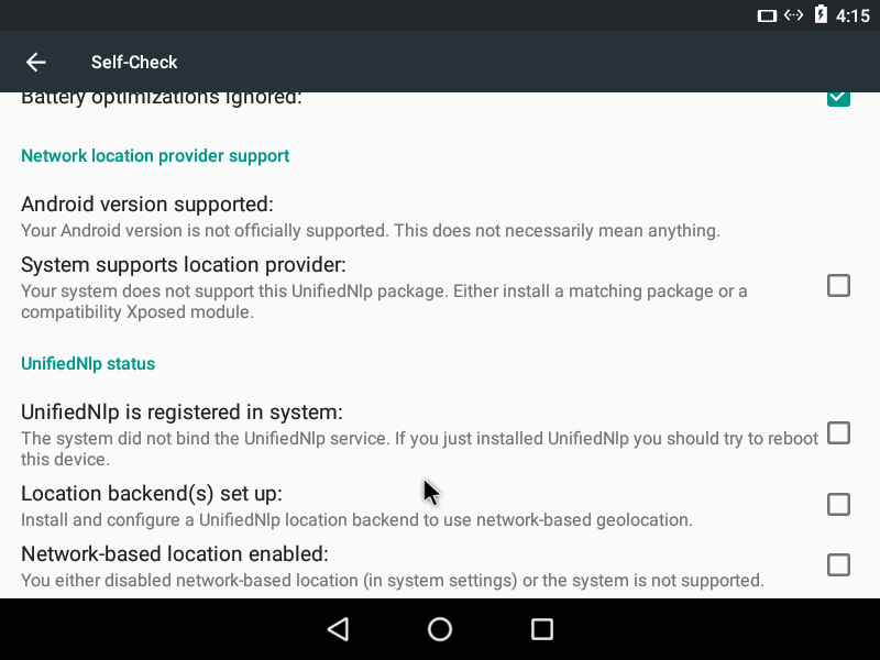

- click on Self-Check
- Check the Network location provider support, it will look as follows:

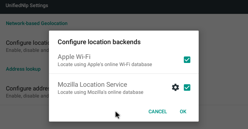

Open microG Settings - UnifiedNlp Settings - Enable Location and address lookup backends

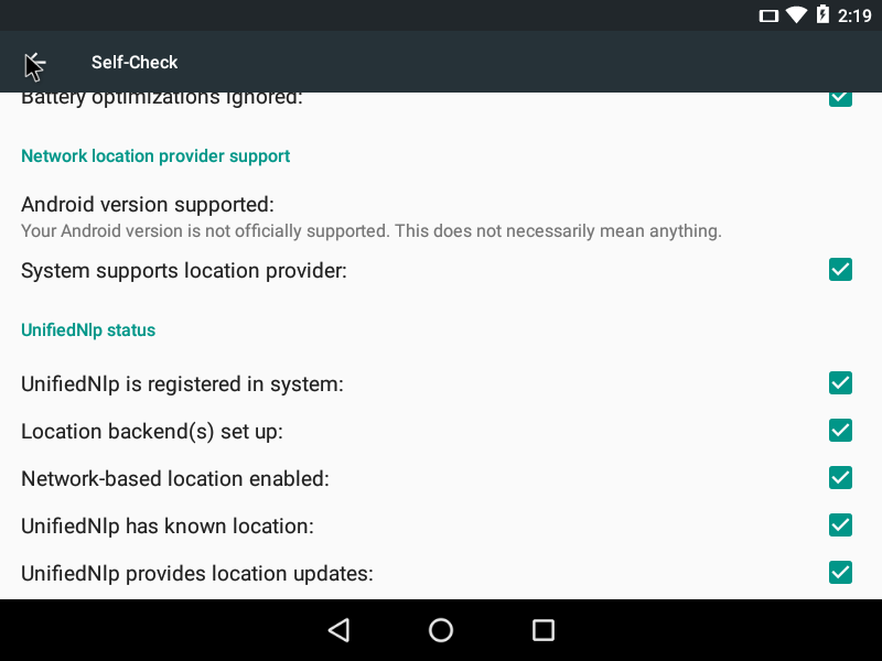

If everything goes well then it will look as follows:

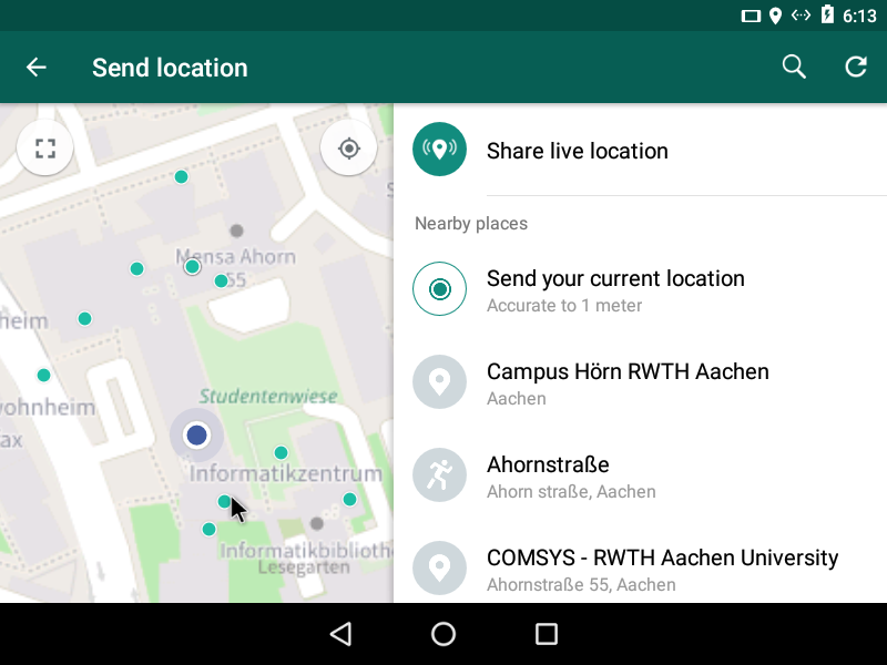

Now open Whatsapp, click on any contact and share your location with him
