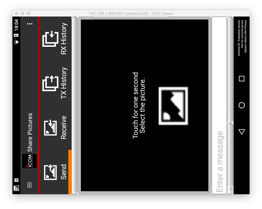

I am using Emteria on a Pi 3B to run a radio application which only operates properly in portrait mode (designed primarily for Android Phone, and needs a long-and-thin aspect to display all the on-screen options - app doesn't scroll!). I have got this running successfully by setting the screen orientation to 270-degrees in the Emteria-specific settings, and by physically turning my HDMI-connected display to portrait orientation.
This works when I am physically present, but presents challenges when trying to access remotely (which is my primary use-case) via the Emteria built-in VNC server, as the VNC session is rotated, as is the mouse pointer control, like so:

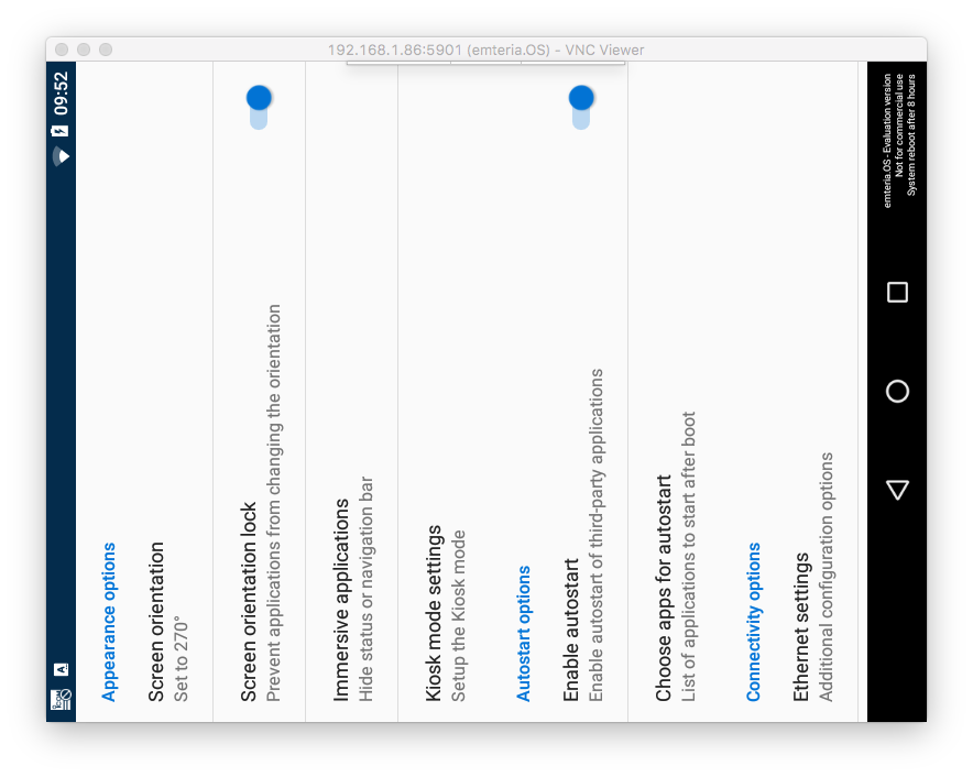

For info, my current Emteria settings are as follows (needed to get the app to run on an attached Portrait-orientated display):
